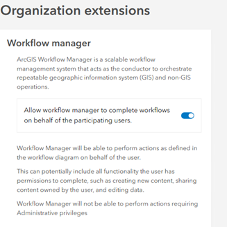

  6. In the Workflow Management section turn on the Allow workflow manager to complete workflows on behalf of the participating users toggle button to enable the task group and task handoff automation between jobs owned by different users.
    Organization extensions Workflow manager options
