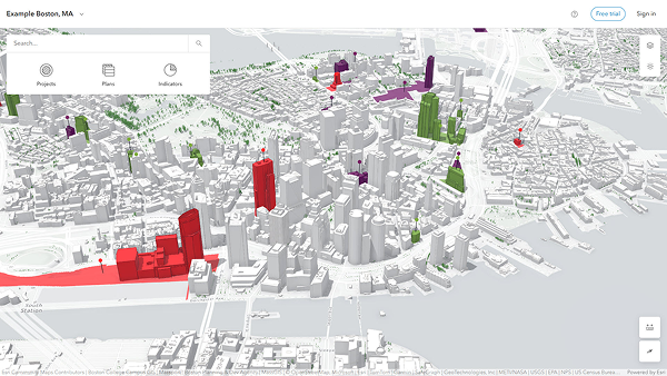

Overview user interface
The overview is a complete view of all plans, projects, and indicators in a city. The overview UI contains the following key elements:
  • The view—A 3D model of a city with plans and projects represented by multicolored buildings, study areas, and pins. Hover over a pin to get more details about the plan or project.
  • The search panel—An interactive side panel with search and filter functionality with a list of plans, projects, and indicators.
The overview is the first thing you see after starting ArcGIS Urban. Depending on your permissions, the overview can be either read-only or the starting point for creating and editing plans, projects, and indicators. As an administrator, you can configure Urban using the data manager in the overview.
The following images show the overview UI (with and without editing permissions):
Overview of Boston, USA
The public content in the overview UI is shown before a user has signed up or signed in.

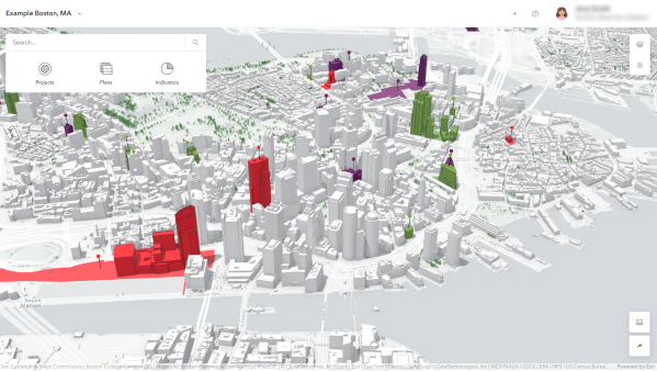

Overview of Boston, USA, with editing
The overview UI is shown for a user with editing permissions, with the Add button in the header.

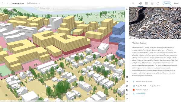

Plan viewing experience
A user who is not signed in can perform the followings actions in a publicly shared plan:
  • View the plan info.
  • Switch between scenarios.
  • Review the content on the map including future buildings.
  • Open the zoning mode and view the boundaries, legend, and numbers.
  • Open the development mode and view the colored spaces, legend, and numbers.
  • Open the dashboard and view numbers and charts.
  • Switch on and off layers.
  • Use viewpoints for navigation.
  • Adjust and animate shadows in the daylight tool.
  • Measure distances and areas, and slice through objects.
  • Take a screenshot.
Viewing experience for a plan in Boston, Massachusetts
The viewing experience is shown for a user who is not signed in.

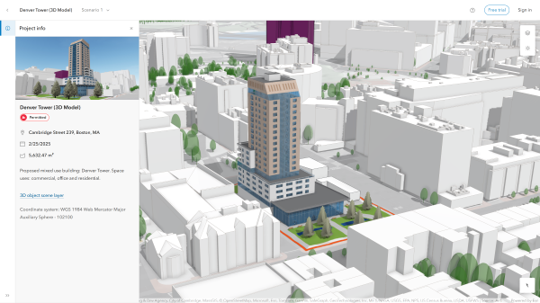

Project viewing experience
A user who is not signed in can perform the following actions in a publicly shared project:
  • View the project info and status.
  • Review the content on the map including 3D models.
  • Review metrics in the dashboard (if they are configured).
  • Use viewpoints to navigate to camera positions (if they are configured).
  • Use the 3D navigation tools.
  • Access the help menu.
Viewing experience for a project in Boston

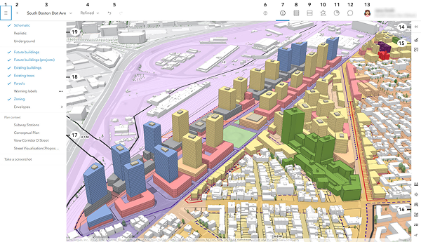

Plan editing experience
While editing a plan, the UI is divided into the following modes, which are displayed to the right of the header:
  • Details Details—View a thumbnail image, the plan description, the start and end date of the plan, and edit the study area.
  • Zoning or land use Zoning—Edit and configure zoning or land use (depending on the type of plan you are editing), overlays, and parcel overrides.
  • Development Development—Edit parcel geometries, apply building types, generate buildings, design and edit spaces, demolish parcels, and assess parcel suitability.
  • Analysis Analysis mode—View analysis tools and a list of already conducted analyses.
  • Dashboard Dashboard—View metrics for the scenario. Change chart types and arrange metrics on the dashboard.
  • Discussion Discussion—Review and comment on the design in user groups and view public feedback.
The plan editing experience is shown with numbered items.
The numbered plan editing experience UI items are described in the following table:
UI item
Description
1—Menu button
Open and close the layer side panel.
2—Return to overview
Close the plan editor and go to the overview.
3—Plan options
Export a scenario to a web scene, save the plan as a duplicate, share the plan, or access the plan configuration.
4—Scenario switcher
Switch between scenarios and access the Scenarios dialog box to add and configure scenarios.
5—Undo and redo
Undo and redo changes.
6—Help menu
Access to a variety of resources about ArcGIS Urban such as the product documentation and what's new blog posts.
7—Details mode
Open the side panel to view a thumbnail image, read the plan description, see the start and end date of the plan, and edit the study area.
8—Zoning mode
Open the side panel to edit and configure zoning, overlays, and parcel overrides. In a land-use plan, the option is Land Use.
9—Development mode
Open the side panel to develop parcels and edit spaces.
10—Analysis mode
Open the side panel to analyze the impact of a plan.
11—Dashboard mode
Open the side panel to show and edit the dashboard with its metrics.
12—Discussion mode
Open the side panel to review and comment on the design in user groups and to see public feedback.
13—Sign-in button
Sign in or out and switch accounts.
14—Expand button
Expand and collapse the side panel.
15—Workflow toolbar
Use tools based on the active mode.
16—View toolbar
Use tools to adjust, navigate, and analyze the view.
17—Context layers
Turn layers on or off. This list is only available if you have added context to the plan or scenario.
18—Design layers
19—Basemaps
Switch between basemap views.

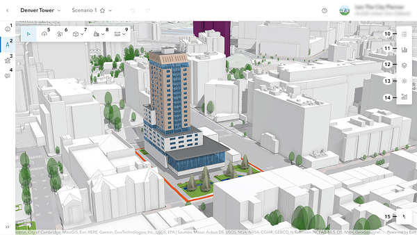

Project editing experience
While editing a project, the UI is separated into four modes on the left side of the view:
  • Info Details—View a thumbnail image, the project description, status, the start and end date of the project, the coordinate system, and more.
  • Development Development mode—Upload a 3D model and add building volumes, assets, and surfaces.
  • Discussion Discussion—Review and comment on the design in user groups.
Project editing experience UI
The UI of the project editing experience is shown with numbered items.
The numbered project editing experience UI items are described in the following table:
UI item
Description
1—Info mode
Open the side panel to view a thumbnail image, read the project description, and see the start and end date of the project.
2—Development mode
Open the side panel to upload 3D models and add building volumes, assets, and surfaces.
3—Analysis mode
Open the side panel to analyze the impact of a project.
4—Discussion mode
Open the side panel to review and comment on the design in user groups.
5—Upload
Select a file to upload a 3D model or an image.
6—Assets
Choose from a variety of trees, vehicles, and furniture to place on the map.
7—Volumes and surfaces
Draw buildings and surfaces to visualize the ground.
8—Demolish
Remove what is currently within the project boundary.
9—Measure tools
Measure distances and areas and slice through objects.
10—Details
Explore the underlying zoning, land use, and parcel data when an envelope is selected.
11—Dashboard
Show and edit the dashboard with its metrics.
12—Layers
Turn on and off layers and switch the visualization mode.
13—Daylight
Adjust and animate shadows.
14—Viewpoints
Add, edit, and use camera viewpoints to navigate in the scene.
15—3D Navigation
Navigate in the scene, take screenshots, and zoom to the study area.
