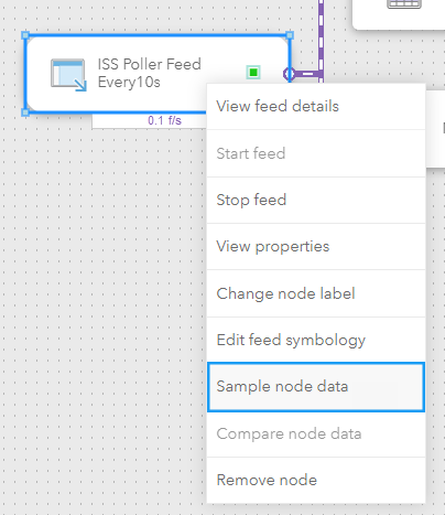

To enable the data sampler in a real-time analytic, the analytic must be started since the data sampler samples records as they are processed by the tool. To begin sampling data, right-click a node in the model and choose Sample node data. This enables and opens the data sampler window.
Sample node data option

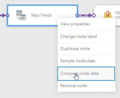

To compare one node to another, right-click another node and choose Compare node data. Sampled values appear in the data sampler pane.
Compare node data option
To sample data on different nodes, right-click a node and choose Sample node data or Compare node data again to sample data between the new nodes (the selected node and the previous node).

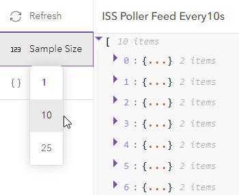

The Sample Size option allows you to choose a sample size of 1, 10, or 25 records. The default is 10 records. Once the number of samples specified by the sample size is reached, the data sampler stops sampling that node. You can click the Refresh button to obtain a new sample set.
Sample Size option

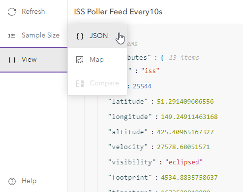

  • JSON—Displays raw data in a JSON format including attributes and geometry. Records and their attributes can be expanded and collapsed. Data can be copied at the desired level, whether that is copying all features, a single feature, the attributes or geometry of a feature, or an individual attribute or geometry of a feature.
    JSON view option

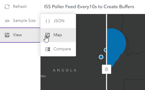

  • Map—Displays the sampled data on a web map. If you are comparing two nodes, the map includes a slider element in the middle. Move the slider to the right to view data from the left node (initial sample) and move the slider to the left to view data from the right node (compared sample).
    Map view option

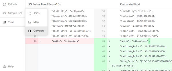

  • Compare—Compares data between the two sampled nodes. If there is no node being compared, the Compare option is not available.
    Compare view option
