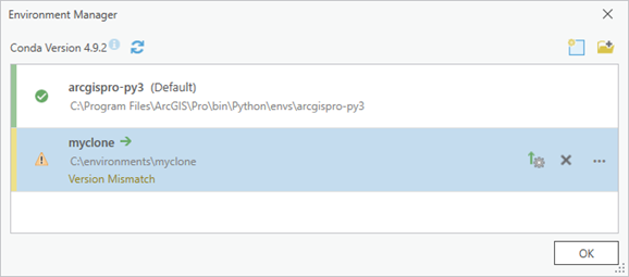

An environment from a previous version of ArcGIS Pro will display a Version Mismatch message on the Environment Manager dialog box.
Version Mismatch

    An environment that needs to be upgraded will be identified by a Warning icon and a Version Mismatch warning message.
  4. Click the Upgrade button on the row representing the environment you want to upgrade.
    Alternatively, right-click the row representing the environment, and select Upgrade.
