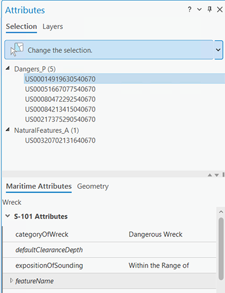

  5. On the Selection tab, click the Select one or more features drop-down arrow to select the features you want to edit, and expand the selection.
    If you selected S-100 features, the Maritime Attributes tab appears in the Attributes pane.
    Maritime Attributes tab in the Attributes pane
    Nota:
    You can choose non-S-100 attributes in the System Attributes section.
  6. Interpret the attribute fields as follows:
    • Regular text—Contains a value.
    • Italics—Empty attributes.
    • Shaded rows—A complex attribute that can be expanded to show the full attribute aggregation.
  7. Check or uncheck Auto Apply and do the following:
    • Checked—Press Enter, or click another field to apply changes to a field value.
    • Unchecked—Click Apply to apply changes to a field value, or click Cancel to restore the last saved value.

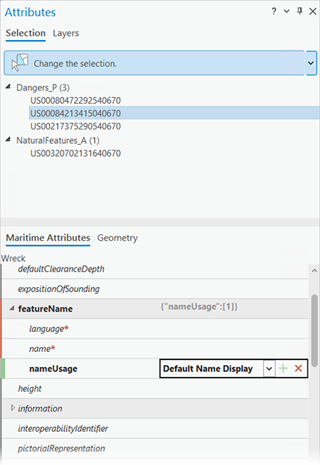

Validation of maritime attributes
The Maritime Attributes tab provides a visual indication of the status of a feature's attributes in the following ways:
  • Green—Required attributes that are valid.
  • Red—Invalid attributes.
  • Bold—The attribute value has been modified since the last time Apply was clicked.
Maritime Attributes tab status visualization
In the image above, nameUsage is set to Default Name Display and is a valid attribute. In the featureName section, the asterisks next to the name and language attributes indicate these values are required for the complex attribute featureName to be valid.
