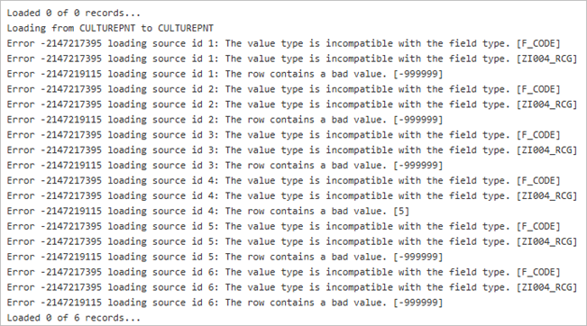

  8. Optionally, check the Log row level errors check box to log errors that occur while the tool inserts new rows into the feature classes and tables of the workspace specified for the Input Target Workspace parameter.
    List of row-level errors
