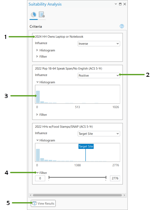

Criteria
The Criteria tab has options to modify the criteria, such as changing the calculation type, the influence, and the minimum and maximum value range.
Suitability Analysis pane Criteria tab
Criterion name
The name of the criterion.
Influence setting
This displays the influence of your criteria using the options: positive, inverse, ideal, or target site. By default, the influence for each suitability criterion is set to positive if no target site is set. If a target site is set, the influence defaults to the target.
Histogram
This displays the distribution of criteria values. The ideal value or target site value, if one is set, is displayed on the distribution.
Filter
Adjust the slider handles to define the minimum and maximum values included in the analysis or enter values manually.
5
View Results
Click this button to open the Results pane.

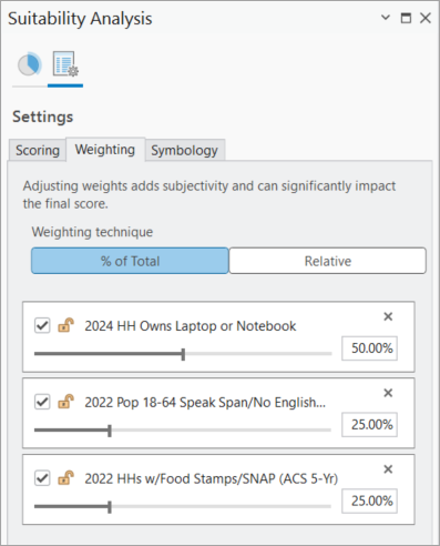

Criteria weighting
Criteria weights represent the relative importance of each criterion as it contributes to the final score. To modify weighting settings, click Settings in the Suitability Analysis pane, and click Weighting. The Weighting section lists the criteria and their weights in the analysis. Suitability criteria are weighted equally by default. However, if some criteria matter more than others, different weighting should be applied.
There are two available weighting techniques:
  • Percentage of Total
  • Relative
Percentage of Total
You can set the criteria weights as a percentage of the total, where the weights for all criteria add up to 100 percent. If you increase or decrease the weight for any criteria, the weights for each remaining criterion automatically decrease or increase proportionately. You can lock values for any criteria by clicking Lock criterion . Locked criteria are excluded from automatic reweighting when a change is made.
For example, if there are three criteria and one is twice as important as the other two, use weights of 50%, 25%, and 25%.
Percentage of total weighting technique

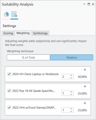

Relative
You can set the criteria weights relative to each other. All weights are set to 1 by default, meaning each criterion is equally weighted. You can adjust these values to change how important one criterion is relative to all others.
For example, changing one criterion's weight to 2 while keeping all other values at 1 means that it will be twice as important as the others in its contribution to the final score.
Relative weighting technique

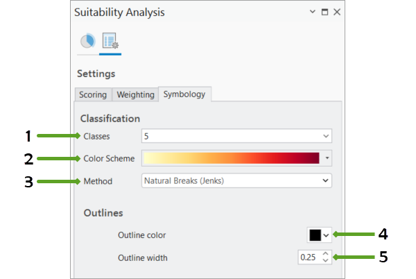

Symbology
A subset of ArcGIS Pro symbology is provided on the Settings tab of the Suitability Analysis pane. You can customize the appearance and construction of your suitability analysis layer using parameters that will persist through changes to your suitability analysis.
Suitability analysis symbology
Number of classes
The number of data groupings symbolized by color in your output data.
Color scheme
The range of colors that will be used to represent your output data. The selected color scheme will persist when change is introduced.
Classification method
The classification method used for classifying numerical fields for graduated symbology. See below for detailed descriptions of classification methods.
Outline color
Set the outline color for polygons in the suitability analysis layer.
5
Outline width
Set the outline width for polygons in the suitability analysis layer.
