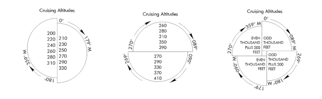

A cruising altitude diagram communicates critical information about cruising altitude levels during flight. The cruising altitude diagram layout element in ArcGIS Pro is highly customizable so you can apply it to multiple charts. There are three types of cruising altitude diagrams:
  • Vertical Cruising Altitude Diagram—The cruising altitude diagram has two sections and is vertically aligned.
  • Horizontal Cruising Altitude Diagram—The cruising altitude diagram has two sections and is horizontally aligned.
  • Quadrantal Cruising Altitude Diagram—The cruising altitude diagram has four sections aligned to the four cardinal directions.
Cruising altitude diagram gallery
Add a cruising altitude diagram
You can add a cruising altitude diagram to the layout in ArcGIS Pro.
