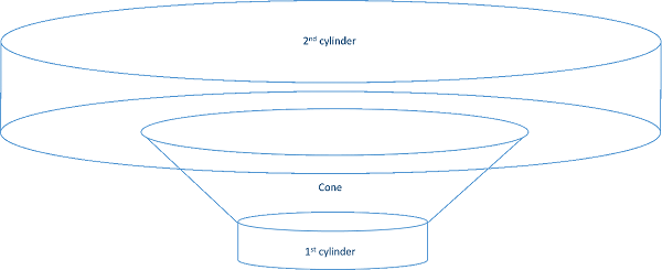

To identify whether buildings cause unacceptable interference to facilities, an international standard has been created to describe the parameters that are used to construct imaginary surfaces around these facilities. The Communication Navigational Surveillance Surfaces tool allows you to create these surfaces in accordance with ICAO EUR DOC 015.

First cylinder radius
Cone radius
Cone angle
Second cylinder radius
Second cylinder height

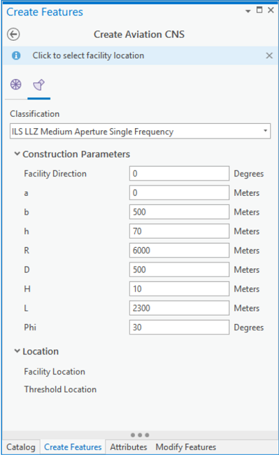

All directional navigational facilities have the following parameters:
  • Facility Direction—Azimuth of the approach runway direction.
  • a—Distance of the surface extending parallel from the antenna along the centerline of the directional fan.
  • b—Distance of the surface extending parallel from the antenna, opposite along the directional fan, along the centerline of the directional fan.
  • h—Height of the directionally sloped plane that describes the minimum height of interference.
  • D—Distance of plane extending from the antenna perpendicular to the centerline of the directional fan. Height is determined by value of (a).
  • H—Height of the surface that extends from the bottom of the antenna up to the specified value that connects to the directional fan.
  • L—Distance from the center of the antenna, perpendicular to the centerline of the directional fan, to the connection point of the sloped directional fan.
  • r—Distance from the base of the antenna; it describes the overall length of the directional fan.
  • Phi—Represents the angle of the directional fan starting at the distance of (D).

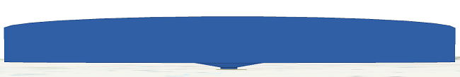

Create CNS surfaces for omni-directional facilities
You can create multipatch features for omni-directional facilities with the Create Aviation CNS tool.
The following example shows the output from the Create Aviation CNS tool:
CNS Omni-directional surfaces

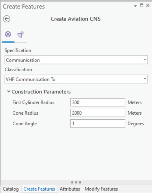

To create multipatch features for Omni-directional facilities, complete the following steps:
  1. On the Edit tab, in the Features group, click Create .
    The Create Features pane appears.
  2. Choose the multipatch layer for which you want to create features.
    The Create Aviation CNS button appears below the multipatch layer.
  3. Click the Create Aviation CNS button .
  4. Click the Omni Direction tab .
    The Omni Direction parameters appear.
    Create Aviation CNS Omni Direction
  5. Choose a specification from the Specification drop-down list.
  6. Choose a classification from the Classification drop-down list.
  7. Optionally, maintain and accept the default values in the Construction Parameters section or edit them.
    Remarque :
    Construction parameters are dynamically dependent on the choices made in the Specification and Classification drop-down lists.
  8. In the scene, click a point for facility location to create a surface.

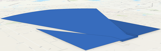

Create CNS surfaces for directional facilities
The following examples shows surfaces created for directional facilities:
CNS directional surfaces
To create surfaces for directional facilities, complete the following steps:
  4. Click the Uni Direction tab.
    The Uni Direction parameters appear.
    Create Aviation CNS parameters
  5. Choose a classification from the Classification drop-down list.
  6. If necessary, accept the default values in the Construction Parameters section, or edit them.
    Remarque :
    Construction parameters are dynamically dependent on the choice made in the Classification drop-down list.
  7. In the scene, click a point for facility location to create a surface.
    Conseil :
    On the Edit tab, in the Snapping group, click the Snapping button to enable your snapping preferences, and move the pointer back to the map.
  8. In the scene, click another point for the threshold.
    The Directional CNS surface is automatically generated.
