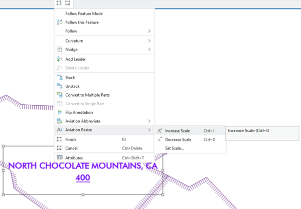

    The Increase Scale option is clicked from the Aviation Resize option of the Annotation menu.
    In this example, the ADHP_C_A annotation feature is selected. The selected annotation feature is from the Airports annotation class.
  3. Right-click the selected annotation feature class, and from the annotation context menu, point to Aviation Resize and click Increase Scale to increase the scale of the label.
    You can also decrease the scale using the Decrease Scale option, or enter a specified value to increase or lower the scale by with the Set Scale option.
