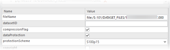

  5. Click the file element under dataDiscoveryMetadata to view its attributes in the editing section, and ensure that compressionFlag and dataProtection are checked.
    When a user permit is loaded, the compressionFlag and dataProtection parameters are automatically checked.
    compressionFlag and dataProtection parameters checked in the dataDiscoveryMetadata attributes
