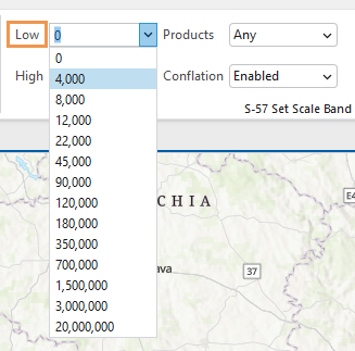

  6. In the S-57 Set Scale Band group, click the Low drop-down arrow and choose a value.
    Conseil :
    You can also type a value in the Low combo box. The value must be greater than 0 and must contain only numeric characters.
    Low drop-down list in the S-57 Set Scale Band group
    In the S-57 Set Scale Band group, the value corresponding to the low value automatically sets the option for the high value. For example, with a low value of 0, the high value is automatically set to 4,000.
