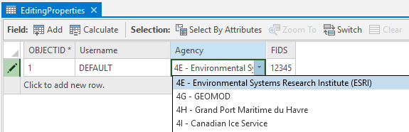

  7. Click the Agency drop-down arrow for the row you want to edit and choose the agency name.
    This field value cannot be null.
    Agency field highlighted in the EditingProperties table
