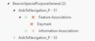

  8. Expand the association to review the associated feature or features.
    Expanded Feature Association in the Association Manager pane

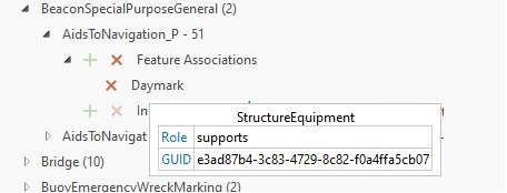

  9. If necessary, hover over the feature to ensure it is the correct GUID and feature that you want to remove.
    Association Manager features with GUID
