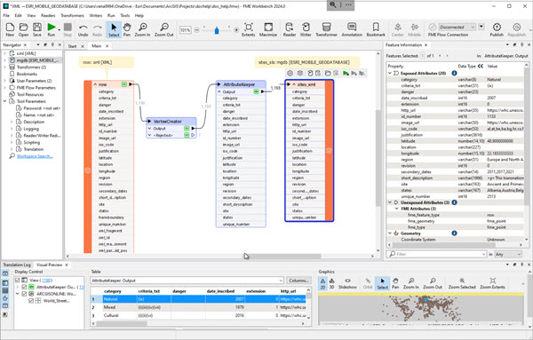

Below is a representation of an .fmw file in the Workbench application.
Workbench
