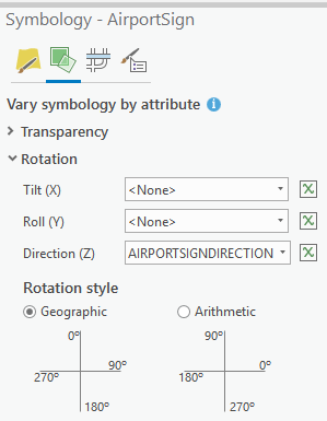

  14. Optionally, enable rotation on the sign.
    1. Click the Vary symbology by attribute tab .
      Symbology - AirportSign Rotation section
    2. In the Rotation section, click the Direction (Z) drop-down arrow, and choose AIRPORTSIGNDIRECTION.
    3. In the Rotation style section, choose Geographic.
    4. Click Save to save the project.
