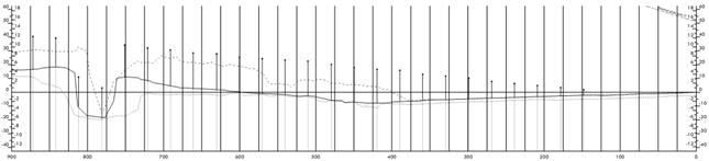

Profile Options tab
Once the Terrain and Obstacle Profile element is visible, further configuration and styling are required to create a finished product. Adjusting the Profile Options settings allows you to create Terrain and Obstacle Profile elements similar to the following examples:
Aerodrome Obstacle Chart profile style
The Aerodrome Obstacle Chart (AOC) profile style is shown.
PATC profile style
The PATC profile style is shown.

Terrain is shown on the Terrain and Obstacle Profile element as a cross-section of where it planimetrically coincides with the OIS layer surfaces. Its display is divided into Max, Centerline, and Min terrain.
Terrain type
Description
Max
Profile of the maximum or highest elevations within the terrain
Centerline
The terrain profile along the centerline of the corresponding OIS layer's features
Min
Profile of the minimum or lowest elevations within the terrain
You can configure each of these terrain divisions using the Display Option drop-down arrow and the Terrain, Symbol, and Color options.
