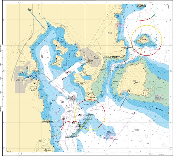

    The INT2 scale bars provided with the Maritime product data files are based on the IHO INT2 specification. The default background color of the scale bars is white so that they can be placed over the outside neatline of the grid.
    Paper chart layout with INT2 Q scale bar positioned on the neatline
