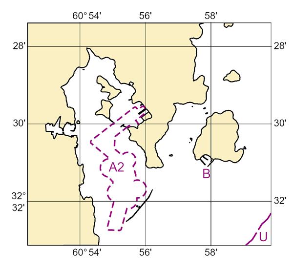

The S-4 chart specification of the International Hydrographic Organization (IHO) defines Zones of Confidence (ZOC) diagrams as a type of source diagram that provides a qualitative assessment of the source information. As with source diagrams, ZOC diagrams allow mariners to assess the quality of the hydrographic data used to compile the chart.
There are two standard ZOC diagram formats: zones defined by outlines with annotation, and color-coded zones without annotation. Examples of these ZOC diagrams are shown below.
Zones of Confidence diagram for a nautical chart
color filled Zones of Confidence diagram
