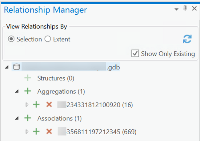

    Relationship Manager pane with Aggregations and Associations nodes
