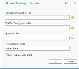

  8. Optionally, click Settings to access the S-58 Error Manager Options pane and specify the product configuration, SCAMIN, ignore list files, and IENC Regional Rules.
    You can also clip features upon export from the pane:
    • Click the browse button under Product Configuration File to choose a product configuration file where the validation data will be exported.
    • Click the browse button under SCAMIN Configuration File to choose a SCAMIN file where the validation data will be exported.
    • Click the browse button under Ignore List File to choose an S-58 ignore list file where the validation data will be exported.
      注意:
      If no ignore list file is selected, the tool will run all S-58 checks.
    • Check the Clip Features at M_CSCL check box to honor M_CSCL boundaries when validating features.
      Because an M_CSCL feature indicates a change in compilation scale, this option breaks features crossing through an M_CSCL and retains the portion that matches the compilation scale area it resides in. By default, this box is unchecked.
      Learn more about exporting to S-57
    • For IENC products, you can specify regional rules. This parameter is only visible when an IENC product is chosen.
    S-58 Error Manager Options dialog box
    Your selections in the S-58 Error Manager Options pane are saved in the ArcGIS Pro project settings.

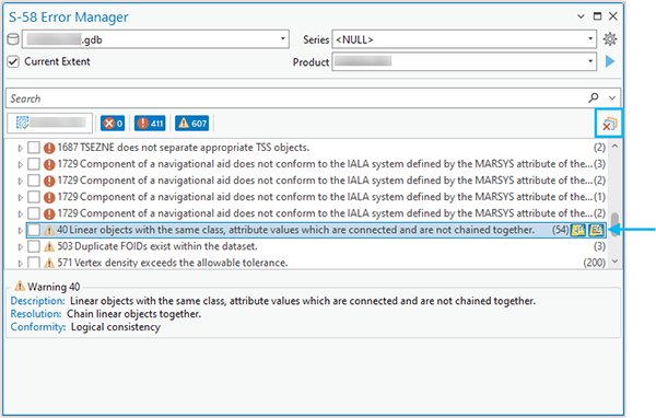

Once the validation process is completed, S-58 results are displayed in the S-58 Error Manager pane. Results are grouped according to severity: critical, error, and warning. You can view specific types of errors in the pane's tree view, which updates dynamically to show the error number entered in the search.

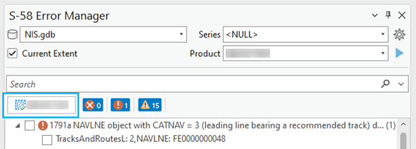

    When validating an extent, you can return the map to the validation extent by clicking the Zoom to extent of validation button , which contains the name of the active product.
    Zoom to extent of validation button in the S-58 Error Manager pane.

  • Hover over an error or warning in the S-58 Error Manager pane to access the Show/Hide children primitive geometry button . Click the button to highlight the corresponding geometry on the map.
  • Hover over a related feature to access the Show/Hide error geometry button where applicable. Click the button to highlight the corresponding feature on the map.
  • Hover over an error or warning in the S-58 Error Manager pane to access the Show/Hide children error geometry button where applicable. Click the button to highlight the corresponding geometry on the map.
  • View primitive geometries associated with a feature on the map by clicking the Show/Hide primitive geometry button next to the feature name.
  • Click the Remove all primitive and error geometries button to manage and clear the pane's tree view. This button is visible when clicking the Show/Hide children primitive geometry button or the Show/Hide children error geometry button .
