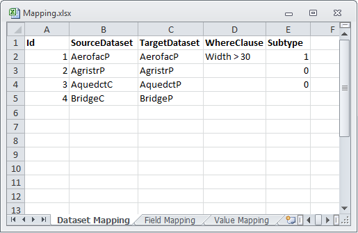

Dataset Mapping worksheet
On the Dataset Mapping worksheet, you can list the tables in the source dataset and specify what tables they should be mapped to in the target dataset. For instance, you can indicate that the RoadL table in the source dataset should be mapped to the Road table in the target dataset. If there are conditions you want to apply to the source data as it is loaded into the target space, you can also add WHERE clauses and a code that corresponds to the subtype.
注意:
The SourceDataset and TargetDataset values are case sensitive and must match exactly when it comes to mapping. For example, AerofacP and aerofacp would be treated as different datasets.
A Dataset Mapping table example
Columns that must be on the Dataset Mapping worksheet are described in the following table:
DatasetMapping fields
Field
Description
Id
A unique identification number that is automatically generated by the database. This identifier is used to reference the dataset mapping in the FieldMapping table.
SourceDataset
The name of the feature class or table in the source dataset.
TargetDataset
The name of the feature class or table in the target dataset.
WhereClause
Define a subset of the source dataset to be loaded into the target dataset. For example, if you are loading lake features from a Hydrography_Areas source feature class into a Lakes target feature class, you can use the WhereClause field to define the condition that must be met before the features are loaded into the Lakes feature class. In this case, the WhereClause attribute could be F_CODE = BH080 when the feature code of BH080 is defined as a lake.
Subtype
Define the subtype in the target dataset into which the data will be loaded. It must be populated when the source and target schemas are different and the subtypes have different codes.

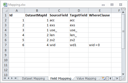

Field Mapping worksheet
On the Field Mapping worksheet, you can specify the fields in the source tables that need to be mapped to the target tables. This can be configured when the name of the field in the source does not match the target. For instance, the name of the length field could be "len_" in the source and "len" in the target. There could also be more obvious differences in field names, such as the name field is "NAM" in one workspace and "NAM1" in the other workspace. On this table, you need to provide an ID number for the table in the dataset, which can be found in the Id column on the Dataset Mapping table.
注意:
The SourceField and TargetField values are case sensitive and must match exactly when it comes to mapping. For example, RoadL and roadl would be treated as different fields.
A Field Mapping table example
Columns that must be on the Field Mapping worksheet are described in the following table:
FieldMapping fields
Field
Description
Id
A unique identification number that is automatically generated by the database. This identifier is used to reference the field mapping in the ValueMapping table.
DatasetMapId
A reference to the dataset mapping record as defined by the Id field in the DatasetMapping table.
SourceField
The name of the field in the source schema.
TargetField
The name of the field in the target schema.
WhereClause
Conditionally map a source field to a target field if the specified WHERE clause is satisfied. The WHERE clause is applied to the source dataset.

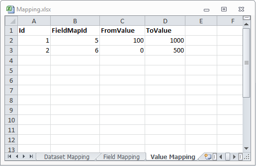

Value Mapping worksheet
With the Value Mapping worksheet, you can override values contained in a source field that would not be considered valid in the target field. For instance, you can replace all occurrences of the value "OPR" with "Operational". The FieldMapId value corresponds to the Id column on the Field Mapping table.
A Value Mapping table example
Columns that must be on the Value Mapping worksheet are described in the following table:
ValueMapping fields
Field
Description
Id
FieldMappingId
The related field map identifier. This value corresponds to the Id field in the FieldMapping table.
FromValue
The source value to be overwritten.
ToValue
The value to map to.
