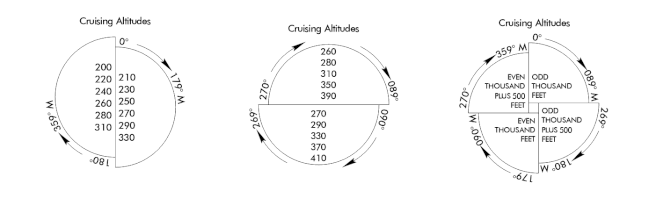

A cruising altitude diagram communicates critical information about cruising altitude levels during flight. The cruising altitude diagram layout element in ArcGIS Pro is highly customizable so you can apply it to multiple charts. There are three types of cruising altitude diagrams:
  • Vertical Cruising Altitude Diagram—The cruising altitude diagram has two sections and is vertically aligned.
  • Horizontal Cruising Altitude Diagram—The cruising altitude diagram has two sections and is horizontally aligned.
  • Quadrantal Cruising Altitude Diagram—The cruising altitude diagram has four sections aligned to the four cardinal directions.

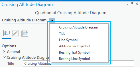

Configure the cruising altitude diagram
The Cruising Altitude Diagram section contains options that define a cruising altitude diagram. To configure cruising altitude diagram options, complete the following steps:
  1. In the Diagram Title text box, type a title for the cruising altitude diagram.
    The title appears as a component on the cruising altitude diagram.
  2. Click the Type drop-down arrow and choose an option:
    • Vertical Cruising Altitude Diagram—The element is a vertically aligned cruising altitude diagram to the layout.
    • Horizontal Cruising Altitude Diagram—The element is a horizontally aligned cruising altitude diagram to the layout.
    • Quadrantal Cruising Altitude Diagram—The element is a cruising altitude diagram to the layout with four cardinal directions.
  3. In the Diagram Diameter text box, type a numerical value and a measurement unit.
    The Diagram Diameter value determines the size of the cruising altitude diagram on the layout.
Cruising altitude diagram options
Diagram text
You can add custom text to sections of the cruising altitude diagram. The number of sections on the diagram depends on the type of cruising altitude diagram you choose. The number of text boxes on the Cruising Altitude Diagram pane depends on the number of sections on the diagram.
Update symbology for cruising altitude diagram components
Cruising altitude diagram elements have several symbol classes that you can modify in the Cruising Altitude Diagram pane to change how the cruising altitude diagram appears on the layout. You can modify symbology for the following symbol classes:
  • Title—The symbology for the title element on the cruising altitude diagram.
  • Line Symbol—The symbology for the cruising altitude diagram's outline.
  • Altitude Text Symbol—The symbology for the text inside of the cruising altitude diagram.
  • Bearing Text Symbol—The symbology for the text surrounding the cruising altitude diagram.
  • Bearing Line Symbol—The symbology for the arrows surrounding the cruising altitude diagram.
Symbol classes for the cruising altitude diagram layout element
