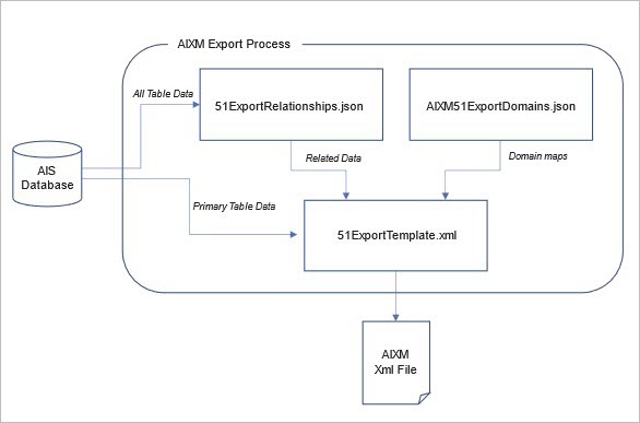

AIXM export diagram
The following diagram shows the three file configurations and how they work together to export AIS data from an ArcGIS database to an AIXM .xml file:
Three file configurations and the export process from an ArcGIS database to an AIXM .xml file
