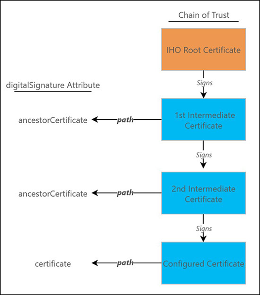

    If your certificate is not issued by the International Hydrographic Organization (IHO), you must populate the ancestorCertificate attribute value. This value must be included for each intermediate certificate that exists. This value links the certificate to the root IHO certificate.
    The chain of trust that links the agency certificate back to the IHO root certificate
