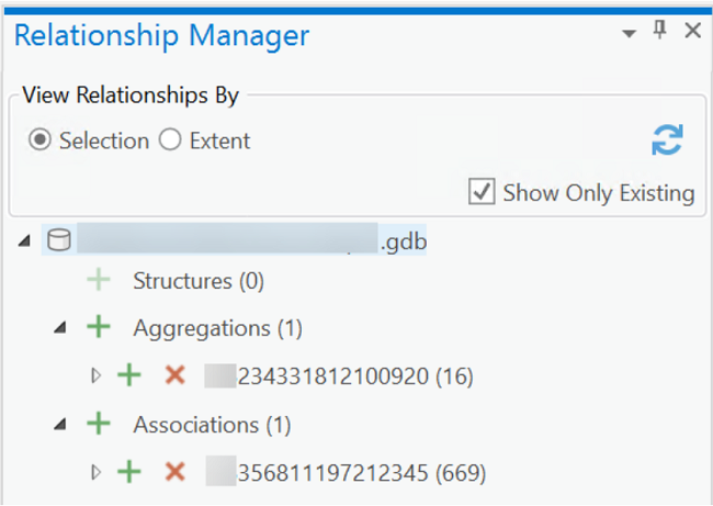

    Append selected features to an existing association or aggregation
    Select the participating features and click the Add button on the node of the relationship to which you want to append the selected features.
    Relationship Manager pane with Aggregations and Associations nodes
