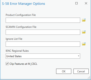

  8. Optionally, click Settings to access the S-58 Error Manager Options pane and specify the product configuration, SCAMIN, ignore list files, and IENC Regional Rules.
    You can also clip features upon export from the pane:
    • Click the browse button under Product Configuration File to choose a product configuration file where the validation data will be exported.
    • Click the browse button under SCAMIN Configuration File to choose a SCAMIN file where the validation data will be exported.
    • Click the browse button under Ignore List File to choose an S-58 ignore list file where the validation data will be exported.
      Примечание:
      If no ignore list file is selected, the tool will run all S-58 checks.
    • Check the Clip Features at M_CSCL check box to honor M_CSCL boundaries when validating features.
      Because an M_CSCL feature indicates a change in compilation scale, this option breaks features crossing through an M_CSCL and retains the portion that matches the compilation scale area it resides in. By default, this box is unchecked.
      Learn more about exporting to S-57
    • For IENC products, you can specify regional rules. This parameter is only visible when an IENC product is chosen.
    S-58 Error Manager Options dialog box
    Your selections in the S-58 Error Manager Options pane are saved in the ArcGIS Pro project settings.

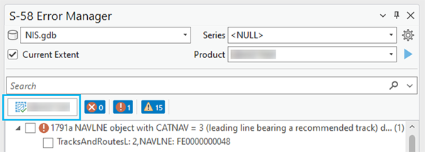

  • Filter the list using the Show/Hide Critical Errors button , Show/Hide Errors button , and Show/Hide Warnings button . You can also use the search bar to search for specific features, errors, or warnings.
    Примечание:
    When validating an extent, you can return the map to the validation extent by clicking the Zoom to extent of validation button , which contains the name of the active product.

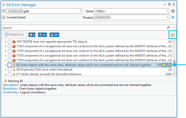

Show or hide geometry
You can show or hide error geometry in the following ways:
  • Hover over an error or warning in the S-58 Error Manager pane to access the Show/Hide children primitive geometry button . Click the button to highlight the corresponding geometry on the map.
  • Hover over a related feature to access the Show/Hide error geometry button where applicable. Click the button to highlight the corresponding feature on the map.
  • Hover over an error or warning in the S-58 Error Manager pane to access the Show/Hide children error geometry button where applicable. Click the button to highlight the corresponding geometry on the map.
  • View primitive geometries associated with a feature on the map by clicking the Show/Hide primitive geometry button next to the feature name.
  • Click the Remove all primitive and error geometries button to manage and clear the pane's tree view. This button is visible when clicking the Show/Hide children primitive geometry button or the Show/Hide children error geometry button .
