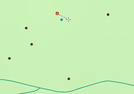

  6. Click once in the active map to create a starting point for the angle, drag the mouse pointer, and click a second point to define the direction of the angle.
    Example of the method used to populate angle values
    The tool automatically pans and zooms to the next feature.
