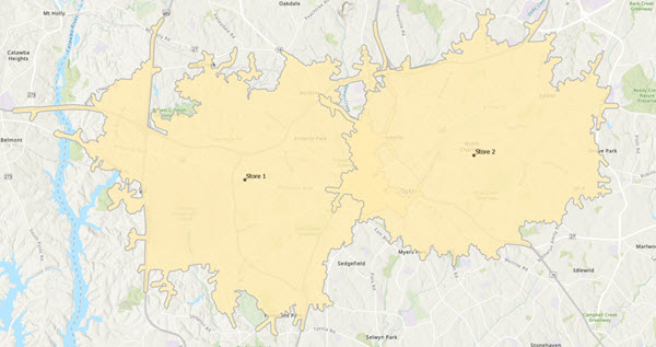

The two stores and their trade areas are displayed below as light-yellow polygons and labeled with their trade area descriptions.
Store trade areas

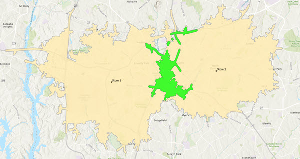

The output feature class from the Measure Cannibalization tool creates a polygon showing the area of overlap between the two trade areas. This polygon is displayed in green.
Cannibalization between store trade areas
