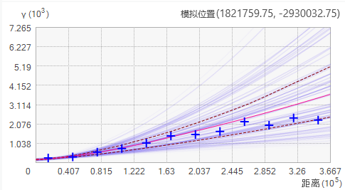

Simulated semivariograms
Simulated semivariograms are shown for one subset.
The number of simulated semivariograms per subset is defaulted to 100, and each of these semivariograms is an estimate of the true semivariogram for the subset.

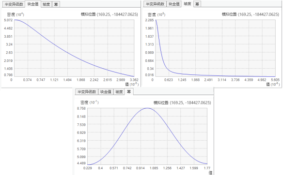

In EBK, it's possible to analyze the empirical distribution of the parameter estimates because many semivariograms are estimated at each location. Clicking the Nugget, Slope, or Power tab displays the distributions of the associated parameters. The following graphic shows the distributions of the semivariogram parameters for the simulated semivariograms shown in the previous graphic:
Distributions of nugget, slope, and power are shown.
By clicking a different location on the preview surface, the semivariogram distribution and the distributions of the semivariogram parameters are displayed for the new location. If the distributions do not significantly change across the data domain, this suggests that the data is globally stationary. The distributions should change smoothly across the data domain; however, if you see large changes in the distributions over small distances, increasing the value for Overlap Factor can smooth the transitions of the distributions.

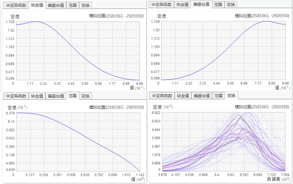

If K-Bessel or K-Bessel Detrended is chosen for the Semivariogram Type, an additional graph for the Shape parameter in K-Bessel will be displayed. An additional Transformation tab also appears that displays the distribution of the fitted transformations (one for each simulation). As with the Semivariograms tab, the transformation distribution is colored by density, and quantile lines are provided.
Distributions of nugget, partial sill, range, and transformation are shown.

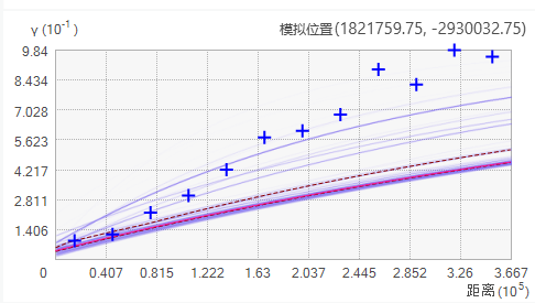

Empirical semivariances do not fall in the middle of the spectrum.

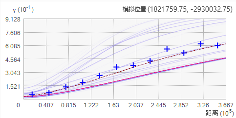

Instead, the following semivariogram should be preferred because the blue crosses fall in the middle of the semivariogram spectrum:
Empirical semivariances fall in the middle of the spectrum.
