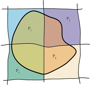

The following diagram illustrates this case. The polygon in the center represents an input study area that is being enriched. For example, the Enrich Layer geoprocessing tool in ArcGIS Pro can calculate the total population for this area. The polygons labeled represent census geographies that contain total population values. In the United States, these can be block groups with enrichment data; in Canada, they can be Dissemination Areas.
polygon

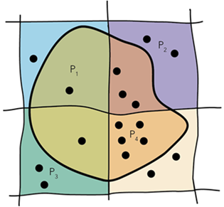

The Weighted Centroid method is illustrated in the following figure:
In the previous figure, census blocks are illustrated as black points. Using area P3 as an example, the population weight for this area is determined by summing the block weights within this polygon. The sum of these weights will provide a proportion of area P3 that is within the study area. Summarizing a demography variable such as the Total Population, will use this proportion to aggregate and summarize data. For example, if 90 percent of the P3 blocks' population are within the study area, and the Total Population of P3 is 100 people, you can determine that 90 people in area P3 are inside the study area.

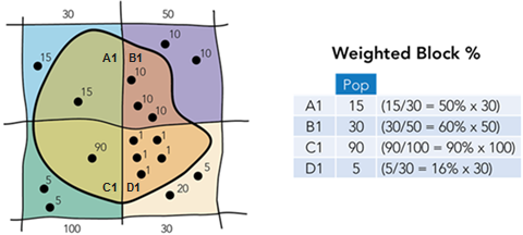

Weighted blocks
The weight w 1 of the site P1 is calculated as a sum of weights of block points belonging to the intersection of the site P1 and the target polygon T:
formula for weight of the site
Here, ß is a block and W1 (ß) is a weight of this block in the site P1.
Summarizing a demography variable such as the Total Population, the weights need to be determined for all intersecting geographies. The GeoEnrichment service calculates the weight W1 (ß) as a ratio of the total population associated with the block (ß) belonging to the site P1 to the sum of total population values for all blocks belonging to the site P1:

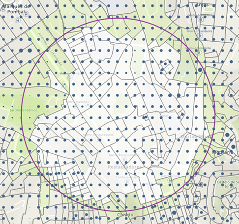

The illustration below shows how the purple ring-buffer polygon to be enriched, relates to the dark blue settlement points and detailed statistical polygons with gray outlines that will support enrichment. Here is how the process works to enrich the purple ring with total population:
  1. Select the statistical polygons that are completely inside the ring polygon. These polygons are shown in white. Compute the sum of the total population variable for these polygons.
  2. Select the statistical polygons that partially intersect the ring polygon. These are shown in light green. For each of these polygons do the following:
    1. Select all the dark blue settlement points that are inside. Using the total population variable from the statistical polygon and the sum of settlement likelihood scores determine the ratio of people per unit of settlement score.
    2. For only the points that are inside the purple ring, compute the sum of settlement likelihood, and from that derive the number of people represented by those points.
      Settlement points
      The dark blue settlement points represent two types of information. First, a regularly spaced, 75-meter grid of points that is produced as described above. Second, because some reporting units are small enough to fall between the 75-meter grid of points, the centroids of these units are added to guarantee these areas are not omitted.
