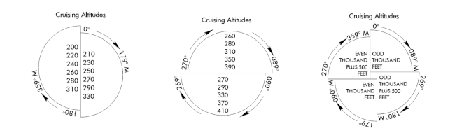

A cruising altitude diagram communicates critical information about cruising altitude levels during flight. The cruising altitude diagram layout element in ArcGIS Pro is highly customizable so you can apply it to multiple charts. There are three types of cruising altitude diagrams:
  • Vertical Cruising Altitude Diagram—The cruising altitude diagram has two sections and is vertically aligned.
  • Horizontal Cruising Altitude Diagram—The cruising altitude diagram has two sections and is horizontally aligned.
  • Quadrantal Cruising Altitude Diagram—The cruising altitude diagram has four sections aligned to the four cardinal directions.
Cruising altitude diagram gallery

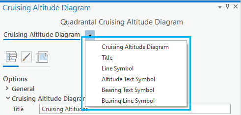

Open the Cruising Altitude Diagram pane
There are several formatting options available to you when configuring the cruising altitude diagram. You can configure the aviation north arrow in the Cruising Altitude Diagram pane.
To open the Cruising Altitude Diagram pane, complete the following steps:
  1. Right-click the aviation north element in the Contents pane.
  2. Click Properties.
    The Cruising Altitude Diagram pane appears.

Update symbology for cruising altitude diagram components
Cruising altitude diagram elements have several symbol classes that you can modify in the Cruising Altitude Diagram pane to change how the cruising altitude diagram appears on the layout. You can modify symbology for the following symbol classes:
  • Title—The symbology for the title element on the cruising altitude diagram.
  • Line Symbol—The symbology for the cruising altitude diagram's outline.
  • Altitude Text Symbol—The symbology for the text inside of the cruising altitude diagram.
  • Bearing Text Symbol—The symbology for the text surrounding the cruising altitude diagram.
  • Bearing Line Symbol—The symbology for the arrows surrounding the cruising altitude diagram.
Symbol classes for the cruising altitude diagram layout element
