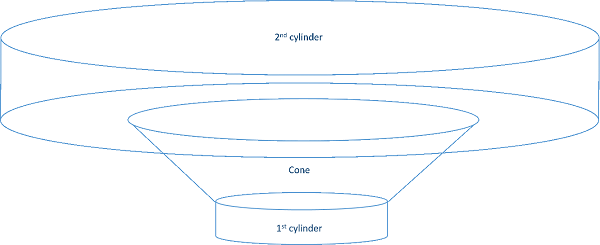

To identify whether buildings cause unacceptable interference to facilities, an international standard has been created to describe the parameters that are used to construct imaginary surfaces around these facilities. The Communication Navigational Surveillance Surfaces tool allows you to create these surfaces in accordance with ICAO EUR DOC 015.
Generalized depiction of surfaces

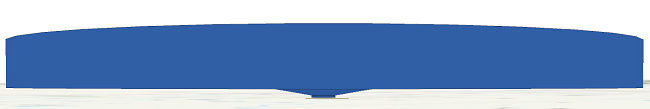

Create CNS surfaces for omni-directional facilities
You can create multipatch features for omni-directional facilities with the Create Aviation CNS tool.
The following example shows the output from the Create Aviation CNS tool:
CNS Omni-directional surfaces

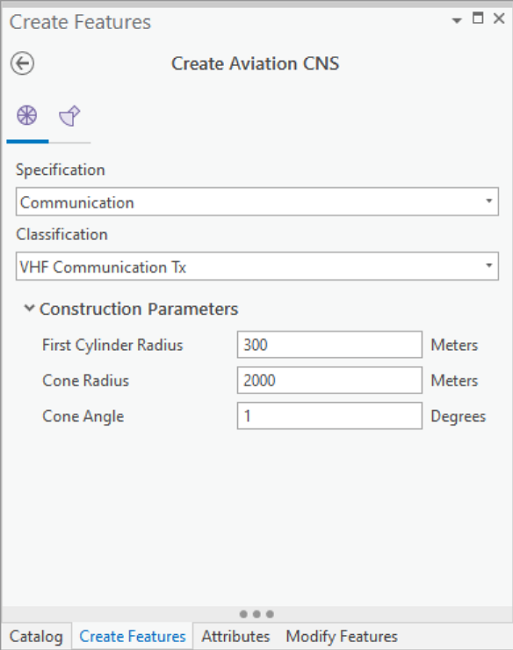

To create multipatch features for Omni-directional facilities, complete the following steps:
  1. On the Edit tab, in the Features group, click Create .
    The Create Features pane appears.
  2. Choose the multipatch layer for which you want to create features.
    The Create Aviation CNS button appears below the multipatch layer.
  3. Click the Create Aviation CNS button .
  4. Click the Omni Direction tab .
    The Omni Direction parameters appear.
    Create Aviation CNS Omni Direction
  5. Choose a specification from the Specification drop-down list.
  6. Choose a classification from the Classification drop-down list.
  7. Optionally, maintain and accept the default values in the Construction Parameters section or edit them.
    注:
    Construction parameters are dynamically dependent on the choices made in the Specification and Classification drop-down lists.
  8. In the scene, click a point for facility location to create a surface.
    提示:
    On the Edit tab, in the Snapping group, click the Snapping button to enable your snapping preferences, and move the pointer back to the map.

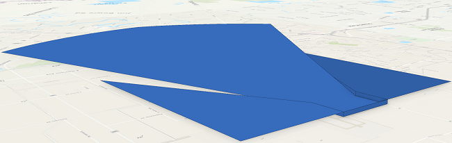

Create CNS surfaces for directional facilities
The following examples shows surfaces created for directional facilities:
CNS directional surfaces

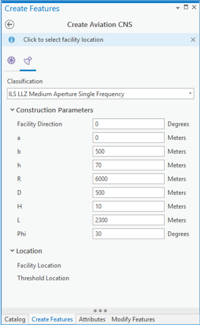

To create surfaces for directional facilities, complete the following steps:
  4. Click the Uni Direction tab.
    The Uni Direction parameters appear.
    Create Aviation CNS parameters
  5. Choose a classification from the Classification drop-down list.
  6. If necessary, accept the default values in the Construction Parameters section, or edit them.
    注:
    Construction parameters are dynamically dependent on the choice made in the Classification drop-down list.
  7. In the scene, click a point for facility location to create a surface.
    提示:
  8. In the scene, click another point for the threshold.
    The Directional CNS surface is automatically generated.
