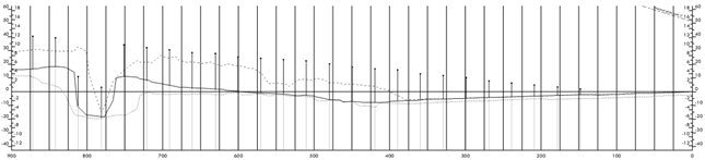

Profile Options tab
Once the Terrain and Obstacle Profile element is visible, further configuration and styling are required to create a finished product. Adjusting the Profile Options settings allows you to create Terrain and Obstacle Profile elements similar to the following examples:
Aerodrome Obstacle Chart profile style
The Aerodrome Obstacle Chart (AOC) profile style is shown.
PATC profile style
The PATC profile style is shown.
