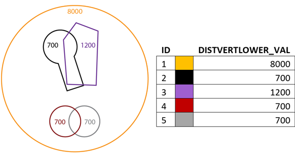

Airspace input
In the following image, five Airspace features of varying DISTVERTLOWER_VAL values are processed with the Label Airspaces parameter checked.
Five input Airspace features after the Generate Airspace Lines tool was run
注:
The preference used in this example was simplified to only process one Airspace label, DISTVERTLOWER_VAL, which is an attribute in the input Airspace features. The Airspace labels configured in the preference will be used during processing to aggregate these Airspace attribute values and populate the AirspaceLine left and right labels with them.

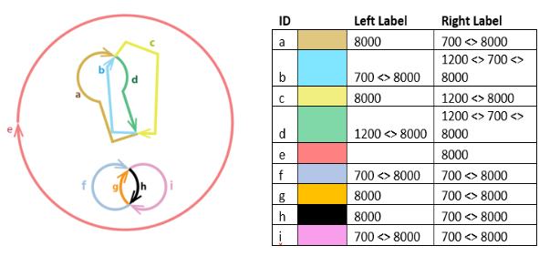

AirspaceLine intermediate results
While the tool is running, the polygons are planarized into lines so that intersecting line features are split into individual segments at each intersection. Nine intermediate AirspaceLine features are produced. The tool then labels the lines. Labeling is done by intersecting those lines with the original polygons to determine what is left or right of the line depending on the label information provided in the Target Airspace Lines Features parameter's LEFTLABEL_TXT and RIGHTLABEL_TXT fields.
Intermediate results showing nine Airspace features after tool processing
注:
The intermediate results are for illustration only and won't directly appear in the AirspaceLine output.

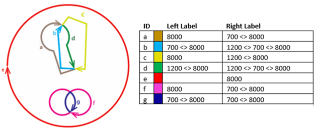

AirspaceLine final results
After labeling, the tool dissolves the intermediate lines by combining lines with common left and right labels. The final seven line features are then copied to the output feature class.
Seven line features processed and labeled
This allows you to form a continuous line with similar intersecting Airspace features, which can only be viewed with AirspaceLine features f and g in the example.
注:
The AirspaceLine feature's left and right labels will also contain information from neighboring Airspace features.

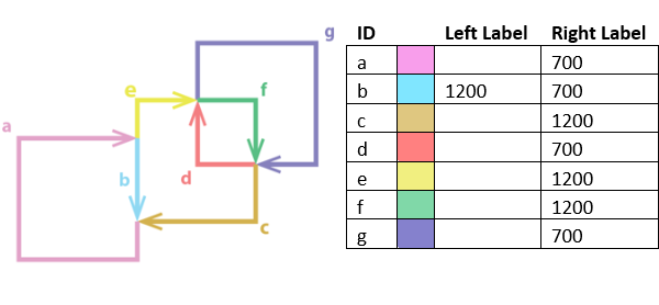

While the tool is running, it planarizes the polygons into seven lines. The tool then labels the lines. The lines do not intersect the Airspace features. Labeling is done by taking each AirspaceLine feature that is coincident with more than one Airspace feature and writing the corresponding Airspace's DISTLOWER_VAL value in the appropriate left label and right label. All other AirspaceLine features that are not coincident with any Airspace features will have their right label populated with the DISTLOWER_VAL value from its originating Airspace feature.
Seven lines generated in intermediate step before final processing
注:
