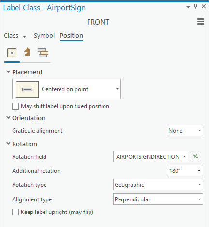

Airport signs can rotate so that the front sign is facing the direction referenced from the value in the AirportSign.AIRPORTSIGNDIRECTION field. This value is the bearing from true north that the sign faces. The back sign renders in the opposite direction of the front sign. If your data contains AIRPORTSIGNDIRECTION field values that don't fit this scenario, you can adjust for that by choosing a value from the Additional rotation or Rotation type options.
If you are working in a rotated map, an additional rotation would be needed on the labels. This can be done by adjusting the expression on the Rotation field drop-down menu to subtract the value of the map's rotation degrees. For example, if the map is rotated to 45 degrees, click the expression button next to Rotation field and alter the expression to say:
  • $feature.AIRPORTSIGNDIRECTION + 180 - 45 for the FRONT label class,
  • $feature.AIRPORTSIGNDIRECTION - 45 for the BACK label class.
注:
You must use different values for the FRONT and BACK classes.
AirportSign label properties for the FRONT label class

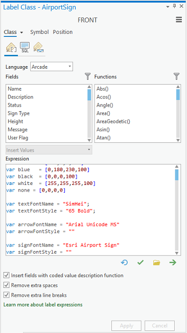

The appearance and content of the sign labels are determined by the label expressions that are used to process the AirportSign layer field values with font and color information. These Arcade expressions are provided in the ArcGIS Aviation Airports product files installer. You don't always need to modify these expressions, but they can be customized.
Modify layer expressions
The Arcade expression files provided in the ArcGIS Aviation Airports product data package provide a customizable label display for your airport signs.
You can find Arcade expressions for both the front and back labels of your airport signs in the \Arcade Expressions\Layers directory within the ArcGIS Aviation Airports product data package. These are already incorporated into the AirportSign_frontBack_layer.lyrx layer file. You can edit these expressions to fit your needs.
注:
You should only edit the layer expressions in the expression editor in the Label Class pane.
The Label Class properties for the AirportSign layer

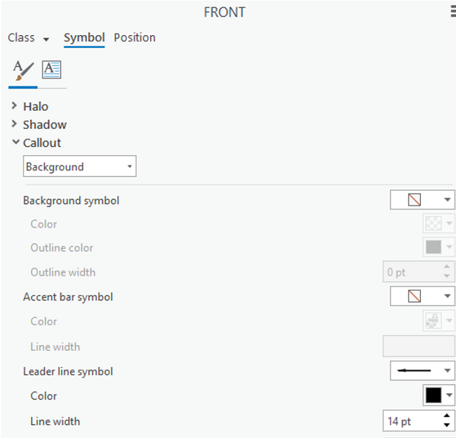

A leader line symbol can be added to either the FRONT or BACK class, but only one class is needed.
  1. On the Symbol tab, ensure that Background is chosen in the Callout drop-down menu.
    Symbol tab of the FRONT class for airport signs
  2. Click the Leader line symbol drop-down arrow and choose a leader line symbol image.
  3. Click Apply.
