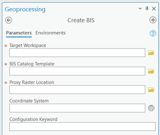

    Create BIS tool Parameters tab
  5. For the Target Workspace parameter, click Browse and browse to and choose the file or enterprise geodatabase where the BIS will be created.
    注:
    It is recommended that you create the BIS in an empty workspace.
  6. For the BIS Catalog Template parameter, browse to <ArcGIS Pro installation location>\ArcGIS\Pro\Resources\Bathymetry and double-click BISCatalog_schema_MGDB.geodatabase.
  7. Choose one of the following BIS schema templates:
    • main.BisCatalog_schema—Contains the default BisCatalog metadata fields
    • main.BisCatalog_bag_schema—Contains the default BisCatalog metadata and BAG fields
    • main.BisCatalog_s102_schema—Contains the default BisCatalog metadata and S-102 fields
    • main.BisCatalog_bag_s102_schema—Contains the default BisCatalog metadata, BAG, and S-102 fields
  8. Click OK to add the template.
    注:
    It is recommended that you copy the schema file to a new location if you want to extend or modify the default configuration so that you can retain a backup of the original schema file.
  9. For the Proxy Raster Location parameter, choose the directory where you want to store the proxy raster .tif files.
    Proxy rasters are automatically created when point cloud data is added to the BIS.
    注:
    It is important that you use a unique proxy raster folder for each BIS you create; otherwise, rasters that do not match a BIS may be flagged or removed when running the Analyze BIS tool.
  10. Optionally, click Select coordinate system and specify a coordinate system for the BIS.
    If no coordinate system is specified, WGS84 is used by default.
  11. Optionally, under Geodatabase Settings, provide a value for the Configuration Keyword parameter.
    The configuration keyword determines the storage parameters of the database table; it only applies to data in an enterprise geodatabase.
  12. Click Run.
