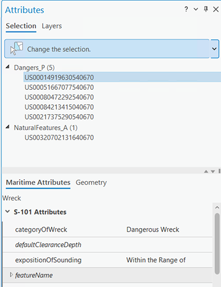

  5. On the Selection tab, click the Select one or more features drop-down arrow to select the features you want to edit, and expand the selection.
    If you selected S-100 features, the Maritime Attributes tab appears in the Attributes pane.
    Maritime Attributes tab in the Attributes pane
    注:
    You can choose non-S-100 attributes in the System Attributes section.
  6. Interpret the attribute fields as follows:
    • Regular text—Contains a value.
    • Italics—Empty attributes.
    • Shaded rows—A complex attribute that can be expanded to show the full attribute aggregation.
  7. Check or uncheck Auto Apply and do the following:
    • Checked—Press Enter, or click another field to apply changes to a field value.
    • Unchecked—Click Apply to apply changes to a field value, or click Cancel to restore the last saved value.

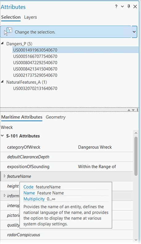

  5. On the Maritime Attributes tab, hover over a field name.
    A tooltip appears with the multiplicity of the attribute.
    Maritime Attributes tab with multiplicity tooltip
    For example, in the image above, the attribute featureName has a multiplicity that allows for 0, or an infinite number of, instances.
