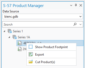

You can use the S-57 Product Manager tool to organize and manage S-57 products and their exports. The S-57 Product Manager tool can be accessed on the Maritime S-57 tab, in the S-57 Editing group. To activate the tab, you must add a feature class from a maritime geodatabase to the map.
You can do the following from the S-57 Product Manager pane:
  • Create a system of series and subseries to organize products in a database.
  • Move products from one series to another.
  • View product footprints.
  • Export a product from a geodatabase.
  • Publish exported products.
  • Reject exported products.
  • View the compilation scale and export history for a product.
  • Save exported products.
Context menu in the S-57 Product Manager pane

  6. In the S-57 Product Manager pane, right-click the product with the footprint you want to view and click Show Product Footprint.
    The product footprint is added to the Product Footprint group layer and the footprint is shown on the map.

  6. In the S-57 Product Manager pane, right-click the product that you want to export and click Export.
    The Export Geodatabase to S-57 tool opens in the Geoprocessing pane and the Source Geodatabase, S-57 Product, and Output Location parameters are populated with information from the product selected in the S-57 Product Manager pane.
