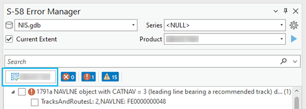

    注:
    When validating an extent, you can return the map to the validation extent by clicking the Zoom to extent of validation button , which contains the name of the active product.
    Zoom to extent of validation button in the S-58 Error Manager pane.

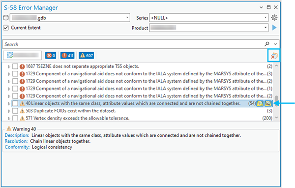

Show or hide geometry
You can show or hide error geometry in the following ways:
  • Hover over an error or warning in the S-58 Error Manager pane to access the Show/Hide children primitive geometry button . Click the button to highlight the corresponding geometry on the map.
  • Hover over a related feature to access the Show/Hide error geometry button where applicable. Click the button to highlight the corresponding feature on the map.
  • Hover over an error or warning in the S-58 Error Manager pane to access the Show/Hide children error geometry button where applicable. Click the button to highlight the corresponding geometry on the map.
  • View primitive geometries associated with a feature on the map by clicking the Show/Hide primitive geometry button next to the feature name.
  • Click the Remove all primitive and error geometries button to manage and clear the pane's tree view. This button is visible when clicking the Show/Hide children primitive geometry button or the Show/Hide children error geometry button .
    Remove all primitive and error geometries button highlighted in the S-58 Error Manager pane
