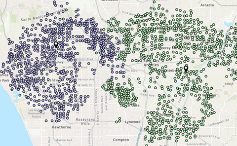

Antique store locations and their customers on the map

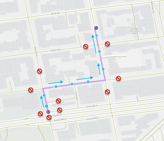

The following illustration shows how the algorithm only considers street segments (blue dots) that lead to the shortest path and ignores all other streets until it reaches the destination:
Streets considered for best shortest path are indicated on the map.

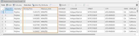

In the output attribute table, examine two key output fields. These fields are determined by the Distance Type and Measure Units parameters. The Measure Units parameter is further dependent on the Distance Type parameter. For example, Measure Units is set to Minutes by default, if Distance Type is set to Driving Time. Depending on the distance type and the measure units specified in the tool, the measures of the output along the shortest path are appended into the attribute table. The other attributes in the output table are from the input store and customer layers.
In this example, Distance Type is set to Driving Time and Measure Units is set to Minutes. Therefore, the output attribute table contains the following fields:
Output attribute table from tool

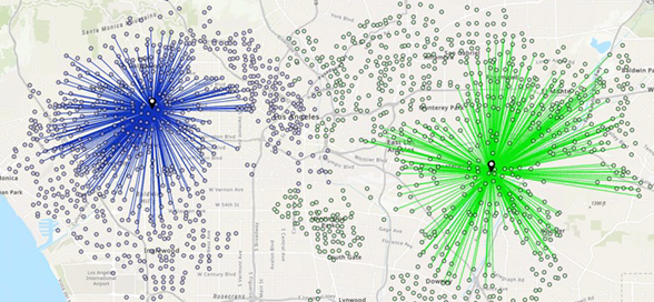

The image below shows the output from the Generate Desire Lines tool. The rays connect to customers who are within a cutoff of 15 minutes from the antique store. Customers that are not connected to the antique stores are those who lie outside the cutoff.
Output desire lines from tool
