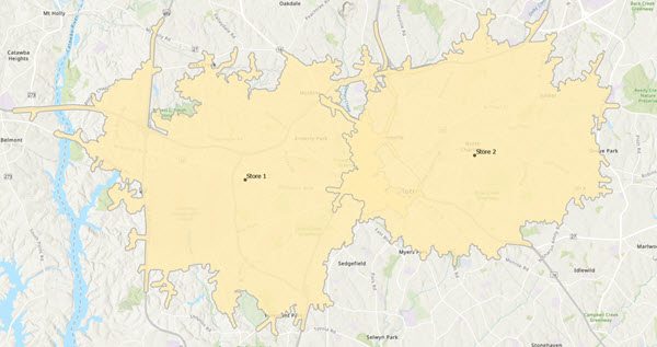

Consider an analysis in which you are assessing the impact of opening a new store (Store 2) whose trade area is going to overlap with an existing store's (Store 1) trade area. You want to know how much overlap there is between the trade areas and what proportion of the overlap falls into each store's trade area. Additionally, you want to analyze how much the cannibalization between the trade areas will affect the amount of 2026 Total Daytime Population shopping at each store. You will add this variable under Additional Metrics to generate cannibalization statistics.
The two stores and their trade areas are displayed below as light-yellow polygons and labeled with their trade area descriptions.
Store trade areas

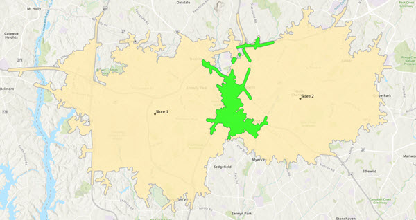

The output feature class from the Measure Cannibalization tool creates a polygon showing the area of overlap between the two trade areas. This polygon is displayed in green.
Cannibalization between store trade areas
