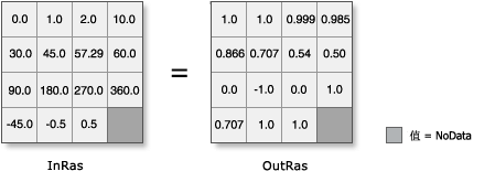

Cos
Cos 图示(将输入由度转换为弧度)
OutRas = Cos(InRas * deg2rad)

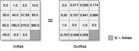

Sin
Sin 图示(将输入由度转换为弧度)
OutRas = Sin(InRas * deg2rad)

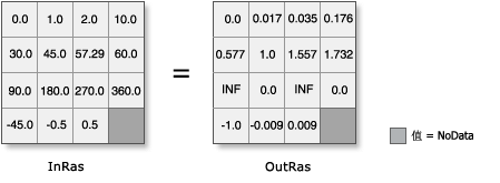

Tan
Tan 图示(将输入由度转换为弧度)
OutRas = Tan(InRas * deg2rad)
