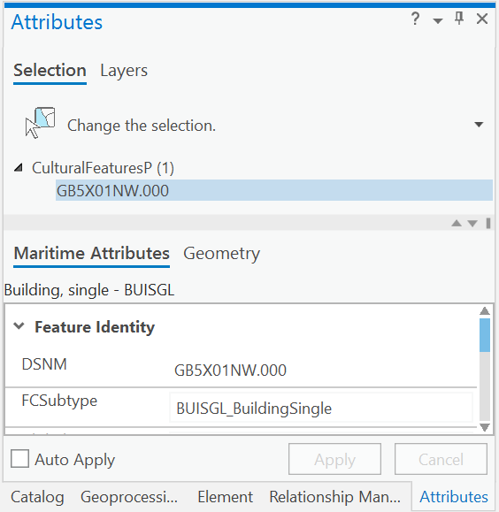

Use the Attributes pane to review and edit feature attributes in logically organized groupings. The Maritime Attributes tab appears in the Attributes pane when an S-57 feature from a maritime database is selected.
Attributes pane with Maritime Attributes tab visible

  4. On the Maritime S-57 tab, in the Selection group, click Attributes .
    The Attributes pane appears.
  5. On the Selection tab, click the Select one or more features drop-down arrow and choose a selection method.
  6. If you choose maritime features from an S-57 geodatabase, the Maritime Attributes tab appears with the following attribute categories:

  8. Click the attributes you want to edit and modify them.
    If Auto Apply is not checked, the edited fields with valid attribute values are highlighted with a green vertical bar.
    If invalid values are entered in any field, the edited field displays with a red vertical bar until the attribute is changed to a valid value.
  9. Click Apply to save your edits if Auto Apply is not checked.
