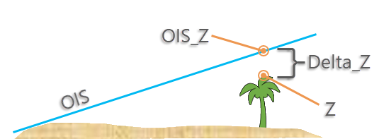

    • OIS_Z—The altitude of the OIS at the obstacle location.
    • Delta_Z—The difference in elevation between the top of the obstacle and the OIS.
      Hinweis:
      Positive values indicate obstacle penetration of the OIS.
