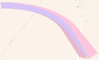

  • If you select the Curved Surface option for the Surface Shape parameter, you must provide polyline features for the Input Flight Path Features parameter for the surface to follow.
    Curved approach surface for helipads
  • The Input Flight Path Features parameter value must be polyline geometry and include an ObjectID field. The polyline endpoint pf the Input Flight Path Features parameter value should be created within a 100-meter search radius of the edge of the Input FATO Features parameter value.
  • The Input Flight Path Features parameter value can be 2D data, because the x and y-values are used to create the direction of the curve.
  • If the PATHID field is included in the Target OIS Features parameter value, it will be populated with the ObjectID value of its source Input Flight Path Feature. This allows Flight Path features to be related to their output curved approach surfaces. The PATHID field (long integer) must first be added to the Target OIS Features parameter value.
