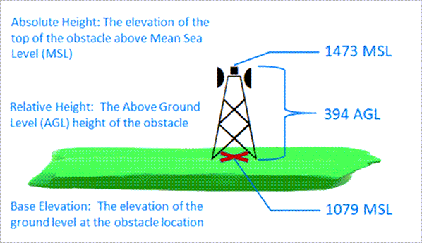

  • The Input Obstacle Feature parameter value elevations are specified by the Obstacle Feature Height Type parameter. Use the Absolute Height option if the input data includes feature geometry or a numeric attribute field with the elevation value of the top of the obstacle above mean sea level. Use the Relative Height option if feature geometry or a numeric attribute field contains the value of the obstacle height above ground level.
    Obstacle feature height types

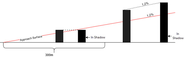

  • You can exclude obstacles in the tool output that are shadowed by other obstacles. The following diagram shows how the Horizontal Distance and Slope parameters are used to generate these output features:
    Shadowed obstacles calculated by this tool
    In this diagram, a value of 300 meters is used for the Horizontal Distance parameter value. For obstacles that are 300 meters or less from the end of the runway, the angle of the shadow will be considered horizontal. A slope of 1.2 is used for the Slope parameter value. For obstacles more than 300 meters from the end of the runway, the shadow will be cast at an object behind the obstacle at a slope of 1.2 percent.
    Hinweis:
    Output of shadowing obstacles is only supported with point obstacles.
