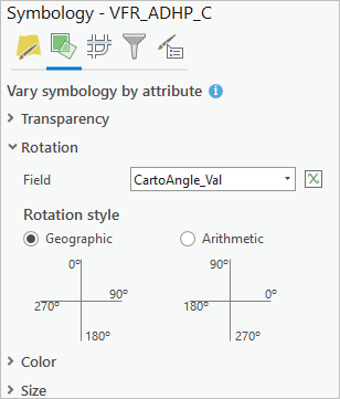

    To view the tool results, you must set the Symbology value for the target point layer.
    On the Vary symbology by attribute tab , expand Rotation, and set Field to CartoAngle_Val, and set Rotation style to Geographic.
