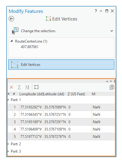

    The selected feature highlights as a sketch in the map and its geometric properties appear in the geometry properties table.
    Edit Vertices
  5. Click the m-value attribute field, type the m-value, and press the Enter key.
    To select and apply the same m-value to multiple vertices, press the Ctrl key, and select the vertex rows in the geometry table. Click Update M Values on the toolbar, type the value in the dialog box, and press the Enter key.
