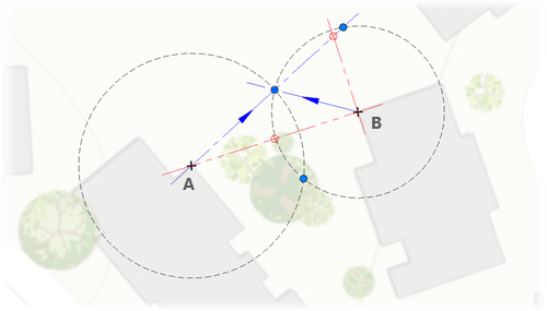

The following diagram illustrates how the intersection tools locate and highlight where specified directions and distances intersect when measured from two known locations shown as points A and B:
Intersection tools
The diagram shows the type of geometric relationships the intersection tools can solve.
